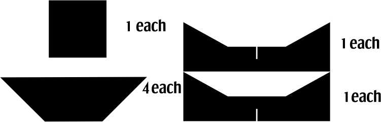

has any one made this and have the dxf file for it?

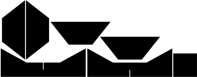

I was looking at this and it didnt line up very well for me so i tweeked a few things and i think this should work but please still check as i havent cut this.
hope this helps as i certainly appreciate all the help that ive been given on here.
Lance

By the way scale to size as this is very small only 18.5" across the flats and about 26" corner to corner.

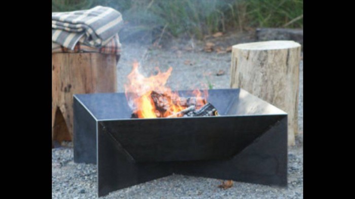

Here is Davidsupershop's file that is posted. This is cut from 1/4" and it measures 30" diagonally.
