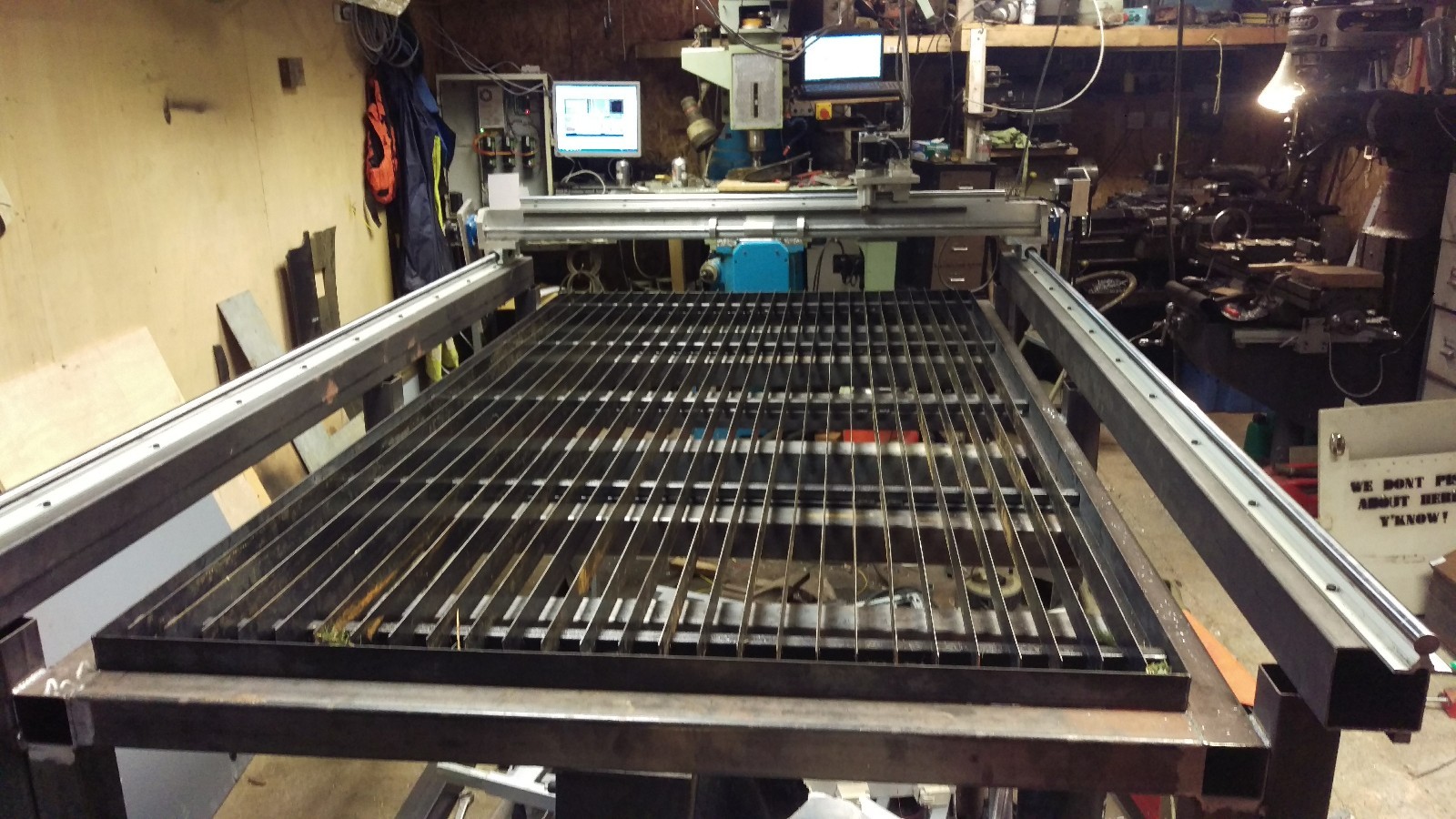

Another 2 things to consider (as I'm fiddling with my table now)
1) consider using RJ45's for sensors and low current wiring (it saves a whole load of time than soldering connections onto an 8-way (9/10 way) connectors ) .... crimp and move on!
2) cable chain helps to keep everything routed and tidy (I use 50x15), basicallly it is the same lenght as my axis as it is folded over in the middle so only 1/2 of it actually moves as its folded over in a "U" shape.
I'll look at numbers later.
fusion 360 >> youtube it is not that difficult... start off with something simple (3x3 X axis extruded 5') and add some end plates to it.

roller bearings in my opinion are better for the plasma environment, quite a few designs used v-groove bearings on v-track (I'm fairly certain the MechMates (used) them with big wood routers too).
https://www.ebay.co.uk/itm/VRD-2-54-5-8 ... SwUoNaEHrq
Linear guides such as the THK are precision guides and provide two axis guidance .... but they don't like fine dust in my opinion.... you can get them with wipers but in a workshop or fabrication enviroment in my opinion over time they won't last because the plasma dust is very hard (think case hardened) and makes a nice grinding paste..... but you could consider the rails as consumabes and replace them from time to time but its an expensive operation (hence my simple bearings running on 2x2 is a low cost problem solver).
Cheapo linear slide rails SBR and round rail from what I have seen have a lot of play in them (I've bought a few to look at)... they won't last long in my opinion..... but I have seen them used on various machines and z axis before.
https://i.ebayimg.com/images/g/lYQAAOSw ... -l1600.jpg
The sales guy is a little wrong in his presentation.... with a router you don't slow down (or you will end up with a tool rubbing), you lower the depth of cut (but I'm splitting hairs)... plus you don't need a powerful PC for sheetcam.... far from it!

There are plenty of commercially built tables using linear guides. I use HGR25 and HGR15 on my machine.
THe SBR's require two rails where the rails only need 1.
Thats the trouble. Everybody has an opinion, its up to you to decide the right path!

If you buy a quality rail (genuine THK or NSK.... i.e. non chinese copy!) then they will work way better than a chinese copy MGN or HGR or HGH etc profile .... which all seemed to have been well copied from the more expensive japanese made THK or NSK rails (in my opinion..... everyone has one and everyone's is different)
You can also design them to be incorporated in such a way that they are protected from any plasma pierce blowback and also use bellows to aide in keeping the muck out.
If you run a chinese copy from the (only) ones I have bought (cost effective and I can afford) they were either very tight and notchy on the rail (and the rail must be bought at the same time as the carriages from the same supplier !!!!!) or the carriages were very loose with a lot of play.
What I did find with my playing around with them..... as I took them off the rail (NOT ADVISED! as the balls fall out!) is that I measured the balls and bought replacement balls is they ran very smooth with the replacement balls and were very low friction with very little play.
As I lost some of the balls from the first one I took off the rail, the second one I took off the rail I did not make the same mistake so I washed everything in paraffin well thinking they may have had the wrong lube on them or dirt in them.
I found that when I lubed both carriages up and put them on the same rail (from the same manufacturer) the carriage that had the original balls in them was still very notchy, but the one with new replacement balls and the same lube (silicone) was very smooth and low friction and no play.
So if I were to buy cheap rails again, I'd do the same thing if they arrived notchy and bin the balls and replace with new once measuring their diameter, clean and re-lube all surfaces.
Again I decided not to use them because of the plasma dust but they were to be used for a Z-axis and floating head assembly, and am presently trying something else using (genuine) IGUS drylin polymer linear slides
https://www.igus.com/info/drylin-linear-guides-overview
Choose one idea, design and run with it....
If you spend say $1000 on linear rail and it lasts you 10 years before you have to replace it your annual cost is $100 / year + ten year down time to replace it + your periodic cleaning and lubing the rail time (5mins a day or once a week compressed air blast whatever you feel you need to do)
If you spend $100 on v-groove roller bearings and replace them every year + annual down time to replace them with lower cleaning / lube time
The operating cost will be the same....
If you sold them both at 10 years the depreciation would probably be the same given the capital cost of the replacement rail would knock a fair bit off the table and also the table with v-groove bearings would probably be worth less to a buyer
Many ways to skin that same cat and spit out the parts you require which is what it is all about the finished article in your hand.....

According to our model, a 40kg (88lb) gantry on linear rails 5:1 reduction, 30mm pinion produces the following resultsEverydayDiesel wrote: ↑Sun Jun 07, 2020 11:57 am I also found this on another site. All though this is for a mill cnc I am hoping that the forumlas work for my application
100 Watts 34878 mm/min (1373 in/min), 1,1 Gs, 1860 rpm
200 watts 49331 mm/min (1942 in/min), 1.5 Gs, 2630 rpm
But when reviewing the torque and current constraints
65 Watts 28000 mm/min (1102 in/min), 0.87 g's 1500 rpm is a more achievable rapid target with plenty of torque left.
In all cases, the time from 0 to rapid speed is 55 milliseconds.
So that really states the case that a well designed carefully matched stepper system is in its element pushing a lightweight gantry around in the absence of cutting forces.

So many questions such a great table:
1. Who made your Z assembly?
2. Why did you put angle iron over the top of the (2x6?) Is the angle flatter then the rectangle tube? https://lh3.googleusercontent.com/pw/AC ... authuser=0
3. What size motors did you use for XYZ?
4. Would you do anything different?
When you say 1/4 wall is too thick are you talking about steel or t6 aluminum (or both)?
I might build something similar to JD2's gantry. I have a miller dynasty welder, but I have never welded aluminum before.
EDIT: Awesome build sir. That is very close to what I am looking at doing. Do you have any CAD drawings of the table? I am actively learning freeCAD (linux) and eventually I will be able to draw my table.
- SeanP
- 4 Star Member
- Posts: 950
- Joined: Thu Aug 01, 2013 11:50 am
- Location: Co Kerry, Ireland
Re: How To Select Motor Sizes
Sorry I wasn't keeping up with the posts there, thought you were still talking about steel box gantry.
The zaxis unit I bought from Velox cnc.
The angle does 2 jobs, well 3 really.
Traps the water tray sides in position, protects to rails from splashing and spatter and I also welded the slat fixing on there to slot into, all still working well.
You see many tables with the side rails level or not much higher than the slats, I took a different view, think mine is 3" taller, to me its ideal, helps to stop splashing, but positioning sheets with the use of a pry bar and tube under the sheet is a godsend, the tube runs across the slats parallel to the length of tbe sheet, then remove it by prying on the rail/angle sides and pulling tube out with a hook, can position a 8x4 sheet of 15mm onto stops easy enough that way, even with the forklift I still load this way.
I used a candcnc bladerunner kit for mine , steppers 620oz, parralell port system, I'm still happy enough with that, thc works great keeps up with anything I cut, 20g to 1" even cutting 2" holes in 4" tube with thc on!
Would I do anything different, well maybe the gantry, running with a single linear rail would be the main thing, having smaller double rail setup would have been better, might still add another smaller rail 90deg to that yet, gantry rack would have been better
facing away from the crap.
Gantry sides could have been stepped back more to make better use of length of table.
Appart from that no all good I think, and its had a good testing!
Hardly stopped since I built it, wish i had kept a track of the sheets, must be a stack 30' tall I reckon!

Sean If you check the torque specs of the rails, with the one rail you have, you are way over designed. I've got 2 x 15mm rails and was thinking if I did it again i'd just use one of them to save a bit more weight! (On a 40 x 80 mm ally RHS)
- Posts: 74
- Joined: Sun May 31, 2020 11:46 am
How much do they weigh? Is it the actual weight or the parasitic drag that is an issue?

I'd still sooner go with a double rail, it's not actual play I can see on mine it's more like give in it when you pull the top of the Z axis, it's only on very fast turns I sometimes see a bit of a rattle in the cut coming off a sharp turn, it does well really.
I'm not really sure of the weight, just looked at the lsk pdf and cant really make it out, can't find a set of scales to weight the spare I'll take a guess 18kg in total, sorry not more accurate.
