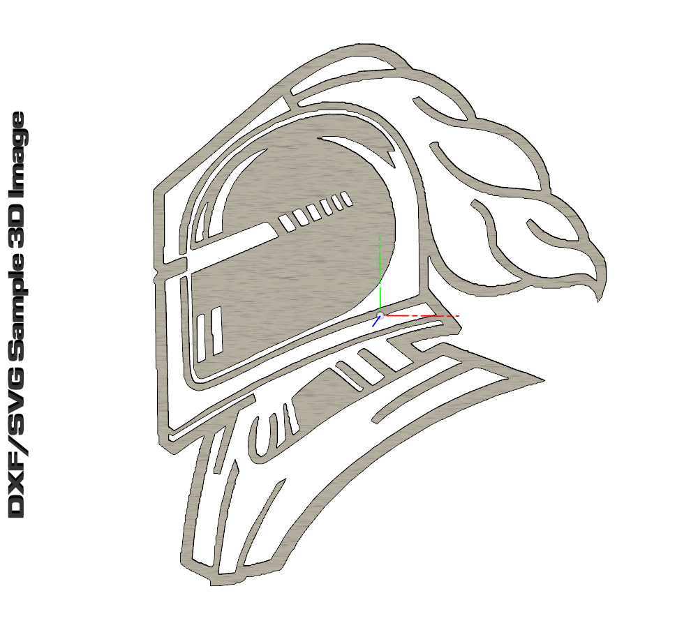

Here is another Knight
Patrick Waite
Posts: 239
Post by Patrick Waite »
Knight.1.dxf
Patrick

hey patrick the file looks great but its not ready for the plasma cutter you have peices that will fall out try to remember that the black is the steel and if its not all attached then its will fall out \
this file could still be used for a sticker or somthing but as of right now not metal

ok Thanks. I sit there and kind of study the drawing after words. Its hard to determin what will fall and what will stay. But thanks for the tip.
Patrick
Posts: 992
Re: Here is another Knight
Post by BrianMick »
patrick that is why i use a paint program on the file and fill the drawing it should all turn black at once if the drawing is cut ready and it helps the customer see what is metal and what are holes because the black is metal...make sense?....
