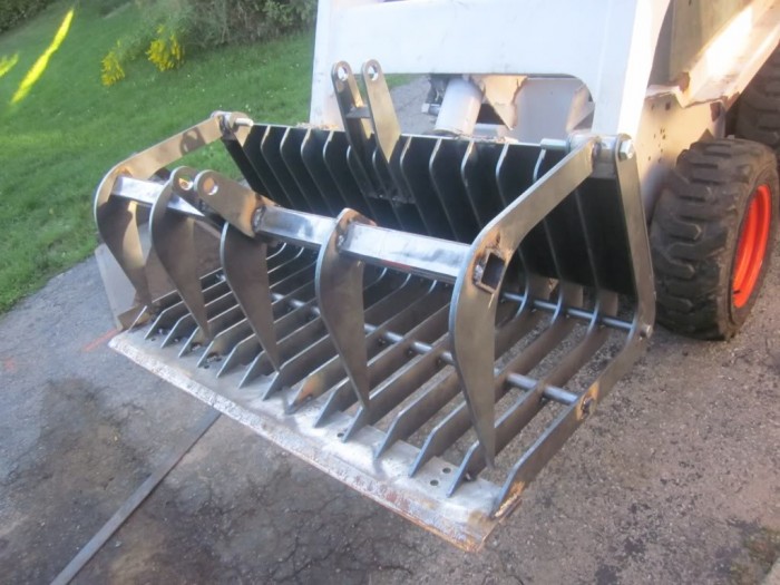

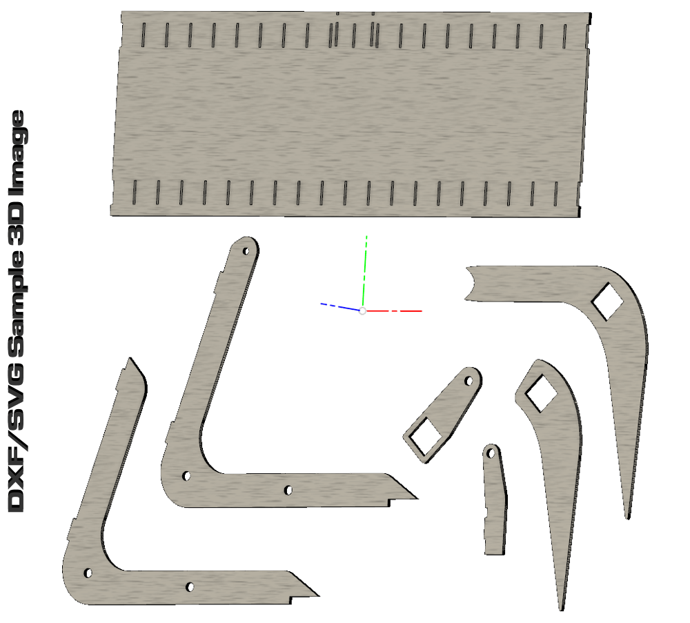

I got a 42" file from SkidRoe off skidsteerfourm.com. Then I used his concept to make a 60" bucket. So here it is..

thats nice fab work !

cool thanks what thickness of metal did u use
- Posts: 5
- Joined: Sun Apr 29, 2012 12:47 am
Re: Giving back
1/4bogger44 wrote:cool thanks what thickness of metal did u use

I have been looking for one of these. That is a nice design.

Nice looking bucket, but I would agree about the blade on front being more of a hinderance than help. It would make it very difficult to just "grab" your vegetation (could be wrong, its been known to happen!). I have operated a JD 260 skidder with grapple bucket for WAY too many years now (about 27-28). My question would be more in the material used. You replied to this question with 1/4", and I feel this is way too light. My grapple is made of 1/2" plate, and I have managed to bend and break the tines on it. It could be that I use mine in a VERY aggressive manner, but still the same, it was meant to be used hard, and in harsh environments. Of course, with that being said... My grapple has far less quantity of bottom "teeth" as well, so the 1/4" may suffice....
No matter the outcome, if it works for you, that's all that matters. It looks like an awesome build!!!! Great job, and thanks for sharing it with us.

Re: Giving back-Grapple Bucket
Thanks for the design! I will be cutting mine out in a couple weeks. What size bore and stroke hydraulic cyclinder did you end up using?

Need this file
- Posts: 8769
- Location: Tucson, Arizona
What format do you need the file in?

What do you open the cdr files with?

CorelDRAW

Thanks for the file, welding one together today! What size of hydraulic cylinder did you use on this?

Is there someone that could convert the corel file to dxf, I use Fusion 360 and cannot open a cdr file. Thanks in advance for any help.
- Posts: 2621
Re: Giving back-Grapple Bucket DXF Design
Looks like the OP posted both a cdr and dxf of the same design. Check the original post again. Files have different names but appear to be the same design.

Gotcha I was thinking the DXF was the common back plate and the other one was the grapple parts. thanks!
