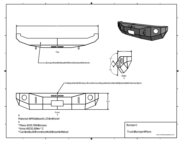

Here's a front bumper in PDF format. Not too hard to change to a dxf.

Do a search for free or online PDF to DXF converters, or try
nirklars.wordpress.com/2015/04/22/pdf-to-dwg-using-free-open-source-inkscape/
You can put all drawing into a dxf this way and work with it in your cutting software.

When I try to convert it. I only get the first page. I can't seem to get the others.

Awesome info. I've done rear bumpers from scratch and there's alot of head scratching on what the end result will look like on the truck. I like the way this one is designed. For anyone that wants to tackle a bumper project: This pdf just gives you the outter "skin" of the bumper. You'll still need to measure and design vehicle specific mounting brackets and winch mounts for whatever you're working on. It is still a great start though.

I drew each piece according to the dimensions in the pdf file in Autocad. So here is the dxf if anyone wants to play around with it.

Thanks for the share. question. What are the slots for?

I made built the front bumper for my 2000 Z71 using the plans from this thread. I did some HEFTY dimensional changes to the original plans in order to get it somewhat close to fitting the curve of the front of the truck. I drew it all in cad, measured the grill line and modeled that in cad, then started pulling lines and changing dimensions. By the time I was done, I probably would've been better off starting from scratch. I built the rear bumper from scratch and it took WAAAAY less cad time. Rear bumpers are easy though because you don't have to fight with matching the curve and grill lines. Eventually i'll build another front bumper for my truck because there's things that bug me and I really want to change and it'll be easier to start fresh with dimensions that I know are correct.S13yeti wrote:Has anyone built one of these yet? Would love to see the outcome
