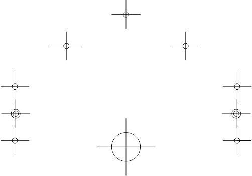

Does anyone have a big block chevy bellhousing bolt pattern?I need to cut out a spacer.Thank you

you bet
chevy-bellhousing-bolt-pattern.dxf

has anyone tried to use this or have a better one? I have cut this several times and it will not line up to and sbc blocks.
Posts: 8673
Re: Chevy bellhousing
HomeMade Fabrication wrote: Fri Jan 14, 2022 9:33 pm has anyone tried to use this or have a better one? I have cut this several times and it will not line up to and sbc blocks.
Which holes don't line up? Personally I would drill the holes (not plasma cut) and only cut the outer perimeter of the adapter plate.

here is what i came up with. try it. i drilled the holes out one size bit size bigger than 3/8
SBC Mid Plate4.dxf

bryantar74 just confirming this corrected plate above. Im about to cut out a mid plate for my LS
bryantar74
Posts: 19
Joined: Wed Dec 12, 2018 11:37 pm
Post by bryantar74 »
just now seeing this. it worked for a SBC 350 to power glide im not 100% sure on an ls but i think they use the same bellhousing pattern as the older small blocks.

Bolt patterns are the same. The LSX uses a center bolt at the 12 o'clock position in place of the top passenger side bolt.
