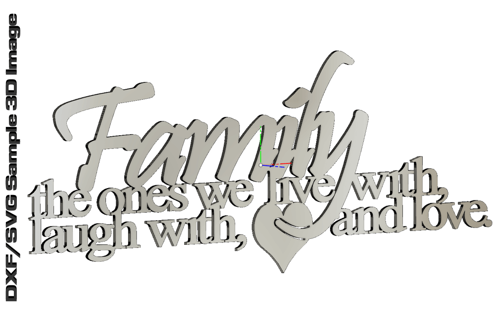

I am still learning, and I would like some criticism. I did this for my friend's girlfriend for a Mother's Day gift.
I had to cut it with zero kerf width to eliminate the crossovers due to tight corners. I also shortened up the line in the heart to increase the distance between it and the edge. It did turn out OK, after that.
I want like to hear any suggestions on how to improve.
Hope someone else can use this...
Stacies family.dxf

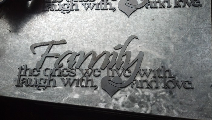

Forgot to add a picture of it cut. Not finished yet, but will be tomorrow...

i think it looks good as well but why modify that lettering? thereis no center to fall out i think it would look better with closed letters... just my $.02

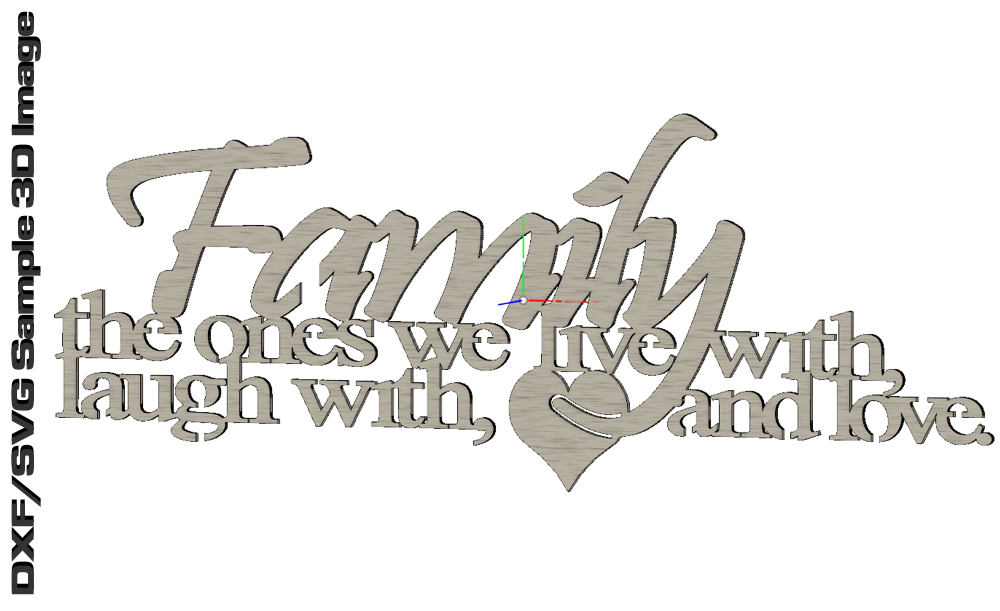

Your design looks great. I hope you don't mind but I closed all the stencil lettering. As Gary had mentioned, there will be no fall outs with the closed lettering.
family.dxf

Gary and Primal, I guess the setting on my machine's software (Design Edge) automatically stenciled that font, and I usually look for that due to fall outs. To be honest, it did not occur to me! :oops: That looks much better...without the stenciling. I am actually going to cut a new one for her...thanks, guys!
