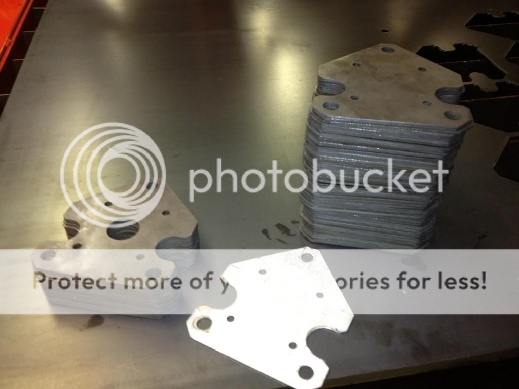

I tried the muriatic acid tonight, and I cant believe how great it worked! Unreal! 1:1 mixture with water....The material is .059 HRS, and I let the parts sit in the solution for 3 hours, and they were totally burr/dross free! The scale is gone, and the parts look fantastic! Man what a time saver! I retrieved the parts with a long magnet, and rinsed them in clean water, then a quick wipe or two with a WD40 soaked shop towel. I just cant believe how great this works!

Muriatic acid is suspended in water. It will eventually evaporate (which is why you need to cover it and also why you don't want it venting inside of your shop). Over time it will get weaker and weaker. Normally I just add another gallon of acid to the mix and all is well for a couple months. If the tub is getting to nasty, I will change out the entire thing and go all new....but that is usually only once every 8 to 12 months for me.
