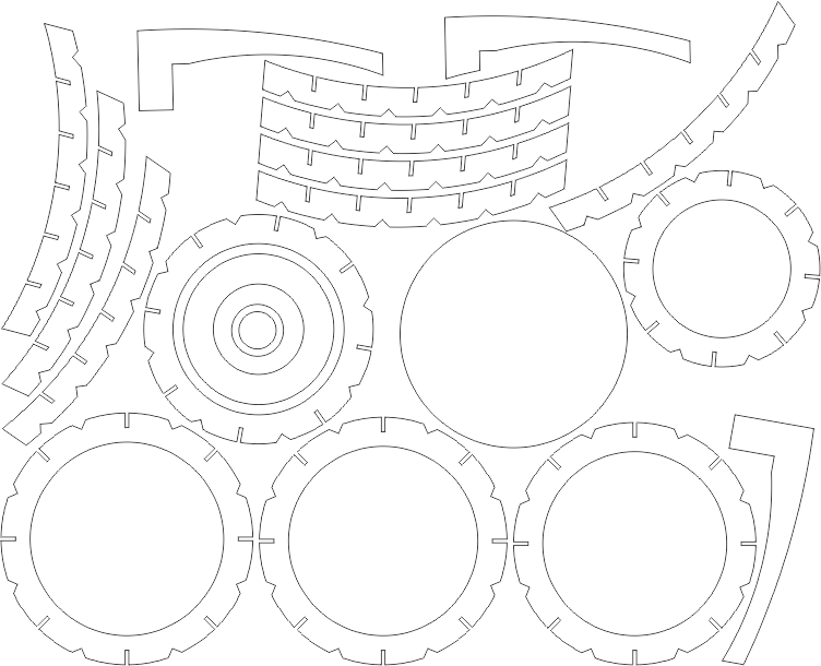

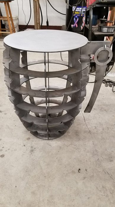

Heres a table I drew up and built not to long ago. I have it slotted for 3/16 plate and it stands right about 42 inchs high.
grenade ready2cut.dxf

All credit goes to the OP, hopefully he won't mind. I resized this table for 24" tall. Slots are .204
Let me know if you want me to delete this post.
Thanks again for the file!
grenade 24 inch tall.dxf

I'm hoping to have a gun room one day and THIS will be in it! Thanks for the share!

No you don’t have to delete it. I have been able to get so many cool things to cut from you guys this is my gift back to all of you. Use it how you see fit. Glad you guys like it and nice to see someone building my design.

Same thing but 18" tall and it can be cut from a 48x38 sheet. Still slotted for 3/16 plate. All vectors are closed and on the same layer. I have not cut this so please evaluate it for errors prior to cutting.
grenade 18 inch tall.dxf

I just stumbled upon this file. Very awesome. I was curious if you tried cutting the rings in half to save on plate space? Maybe you tried it and it didnt save enough space to make the work worth it.

Would someone explain why the 18" and 24" files open at less than 2"x2" cut files?
