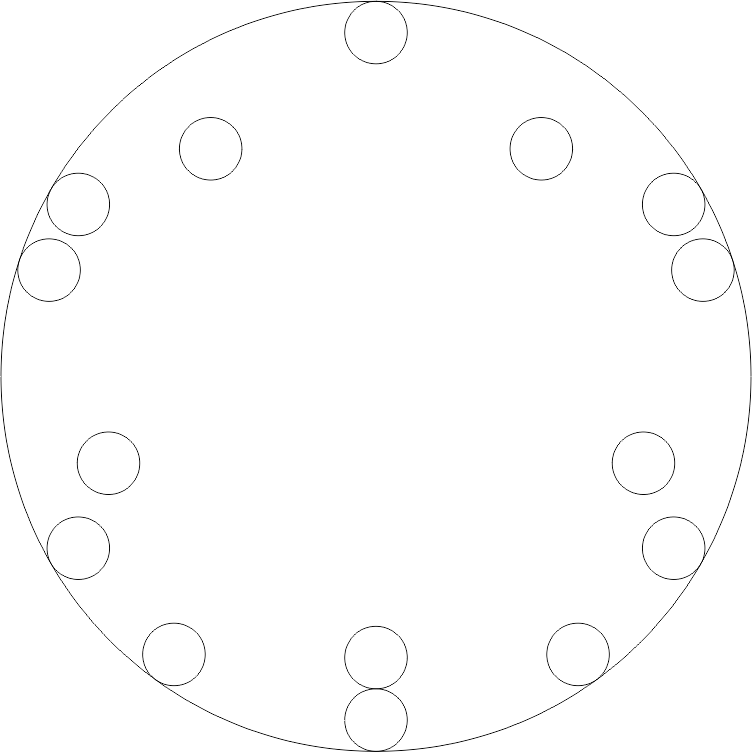

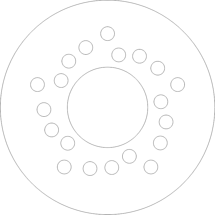

This is what I'm looking for . Apparently these are good for putting on rims to remove cars from fields . after being welded on rims they will fit any bolt pattern . If anyone has this to share that would b great !!
Does anyone have wheel bolt patterns

My software will make flanges, ie bolt patterns. Just need to know ID, OD, the diameter of the holes and the cirlce the holes are on and how many (ie 5 holes on a 4 1/2" circle, 7/8" holes) with whatever ID and OD you want. PM or post it up here which ones you want and I will frankenstein them all together.

Pulled this from Google don't know if its correct but looks like 3 patterns.

I could so use this just as the OP stated. Its only temporary for getting vehicle/equipment on a trailer and getting home. We have a couple of double pattern wheels that we use regularly for retrieving cars and trailers and such.
If anyone can make one up you will be my hero!!!

Here is one I created, but I had never cut it. It is only for 5 bolt patterns at 5.5, 4.5, 4.75, and 4.0. I know the 5.5 and 4.5 work on most trucks, not sure about the others.
This is the solidworks model if interested.

Thanks for the share pertneer, I've had a need for one these from time to time but just never bought one. I'll cut one and give it a try.
